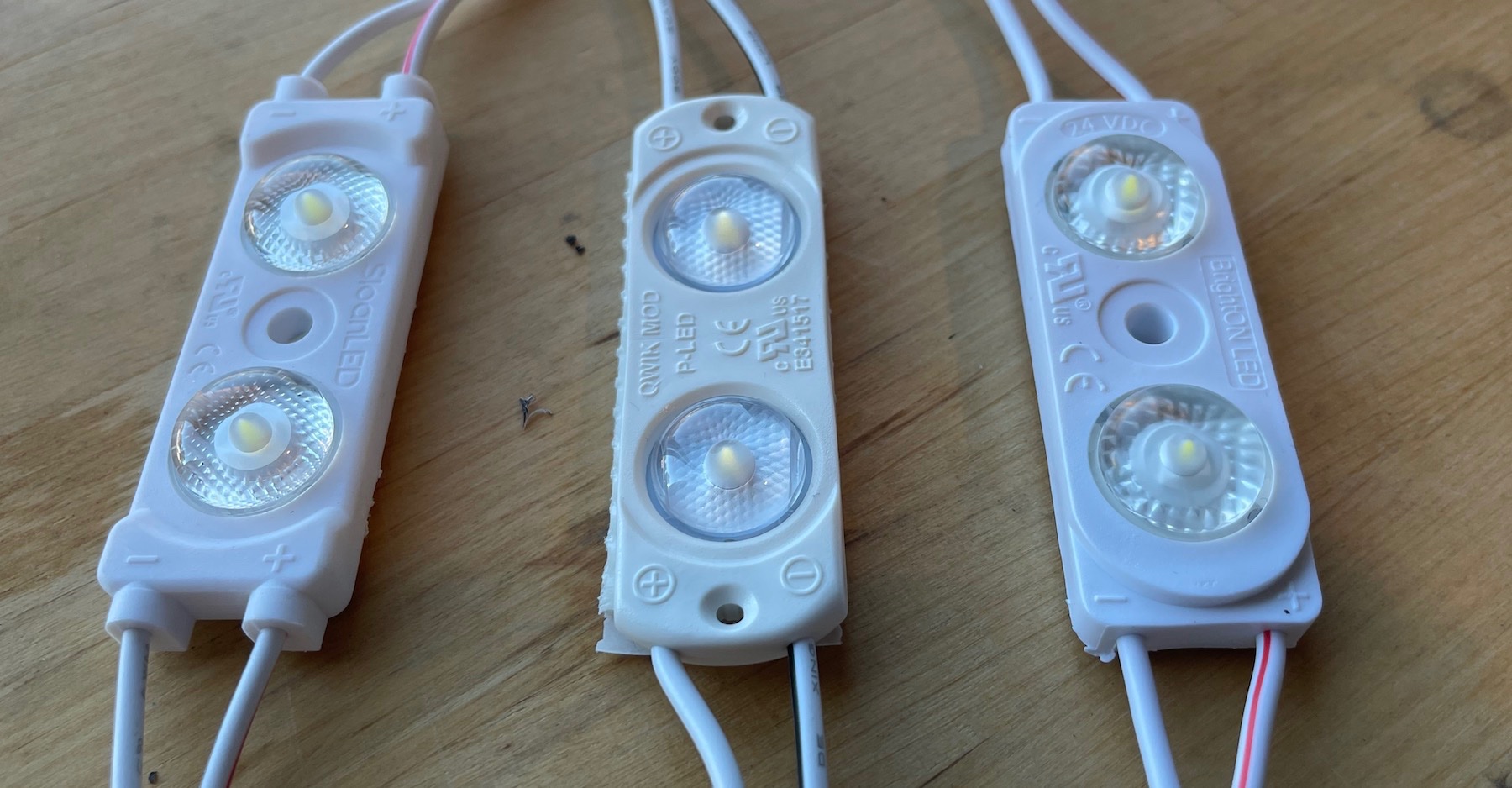

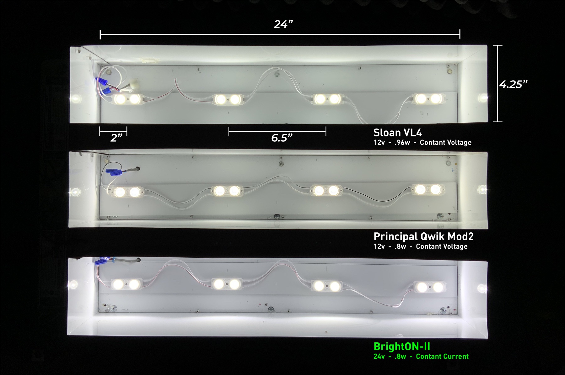

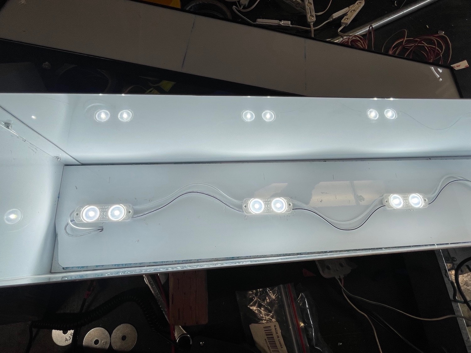

Sloan LED Value Line 4 (Left), Principal LED Qwik Mod (Center), BrightON II LED (Right)
The Benchmark Comparison Details

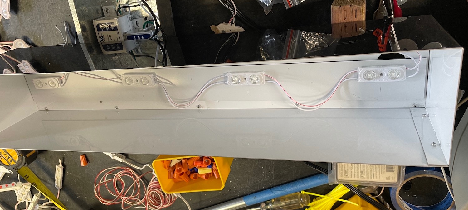

Each Channel is 24” L x 4.25” W x 5” Deep.  Why 4.25” Width?  Well, because the standard told you that each stroke of Neon should hold for 4”, at 6” or 8” you would add another.  The acrylic face is just a simple 1/8” #7328 MC White.  The module spacing for all modules is also the same at 6.5” OC
The first thing you should know is that the BrightON II is Constant Current Module, NOT Constant Voltage.  Both the Qwik Mod2 and VLT 4 are Constant Voltage.  We’ll get back to this part in a bit, and maybe we will follow through in a separate article when it comes to CC vs CV and what the pro’s and con’s are.
The BrightON II uses 18AWG for the module system wiring, the Qwik Mod2 and VL4 both use 20 AWG, so they will both incur some voltage loss in longer string strands, especially if it's s shop who likes to load 30 to 50 modules on a single string, this 20 AWG wiring doesn’t not help a Constant Voltage LED System, this works against it.
The BrightON II is 24V, the Principal LED Qwik Mod 2, and Sloan VL4 LED modules are 12V.  With 24V you have half the current flowing across the system, which in turn means less heat and resistance than a 12V system.  This also means, longer life.
The BrightON II is .8 watts per module, the Qwik Mod 2 is also .8 watts per module, the Sloan VL4 however is a higher wattage module at .96 watts.  Usually higher wattage means higher light output.

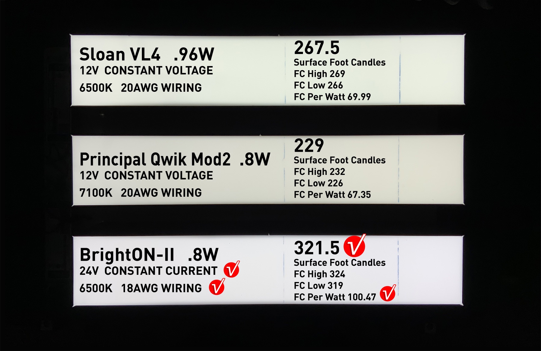

Since we’re in America, we’re using Foot Candles to measure Light Output, in a measured off area on each acrylic face (6” x 4.25”) we use an ExTech Light meter to measure the High and Lows, just like we have done in all past Benchmark Lighting Comparisons such as The Great White Hope, The Red Light District, & Blue Light Special.   We add both measurement (High's & Low's) numbers together and divide by 2.  i.e. FC High of 232 + FC Low of 226 = 458 FC.  458 FC / 2 = 229 FC, or 229 Foot Candle Average.
As you can see, for the same power modules, the BrightON II is 29% brighter on the sign surface (Luminance), and 17% brighter than the higher wattage Sloan VL4.
Lastly, let’s look at the Foot Candles Per Watt.
This is the amount of light per watt on the acrylic or sign face surface.  This illustrates the efficiency of each module, or light output per water being consumed.  Depending on the quality of the chip, some will produce more light than others consuming the same amount of power.  The BrightON far exceeds the Principal Qwik Mod 2, and the Sloan Value Line 4 in light efficiency.

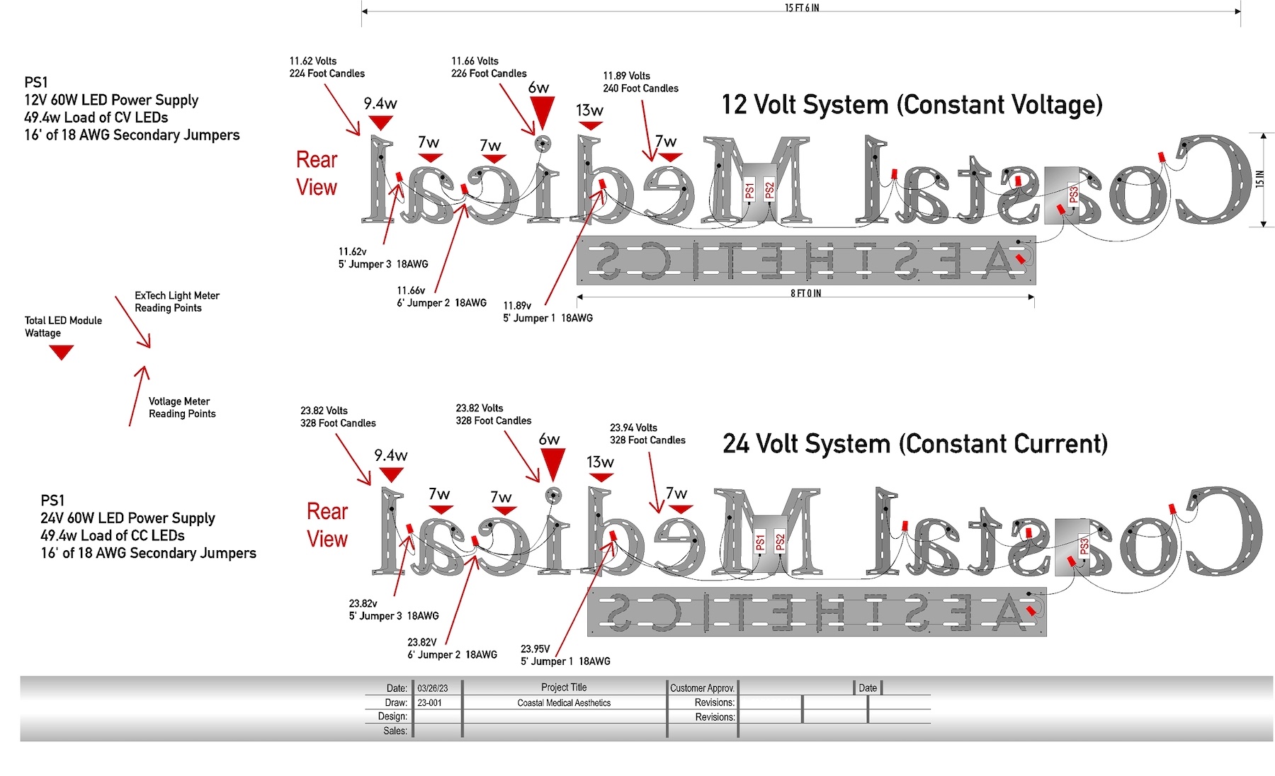

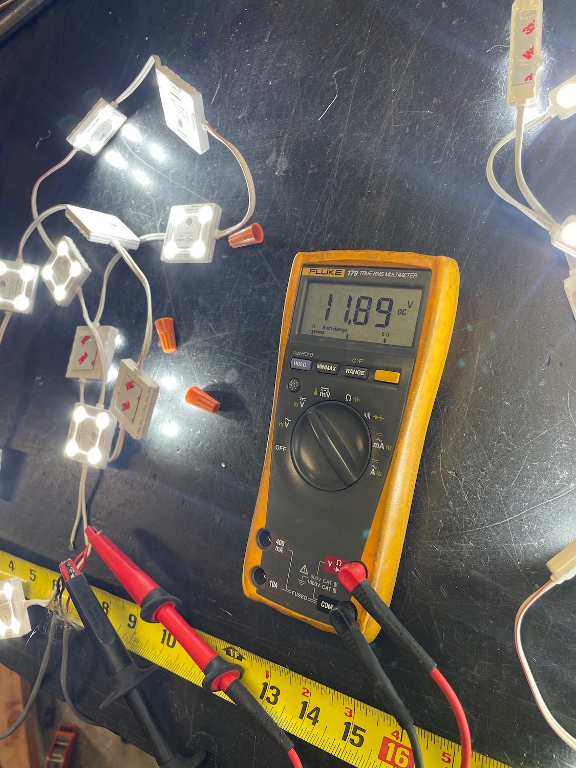

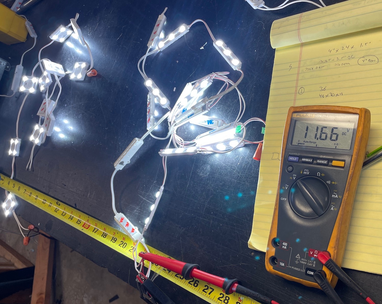

We simulated this small sign using 18 AWG wiring hooked up to measured LED Strings.  We took a 12V PSU and hooked it up to three groups of LED Strings with Similar Loads to represent individual channel letters
I also drew up a illustration to show you what we did for our benchmark test, and what his benchmark is representing.

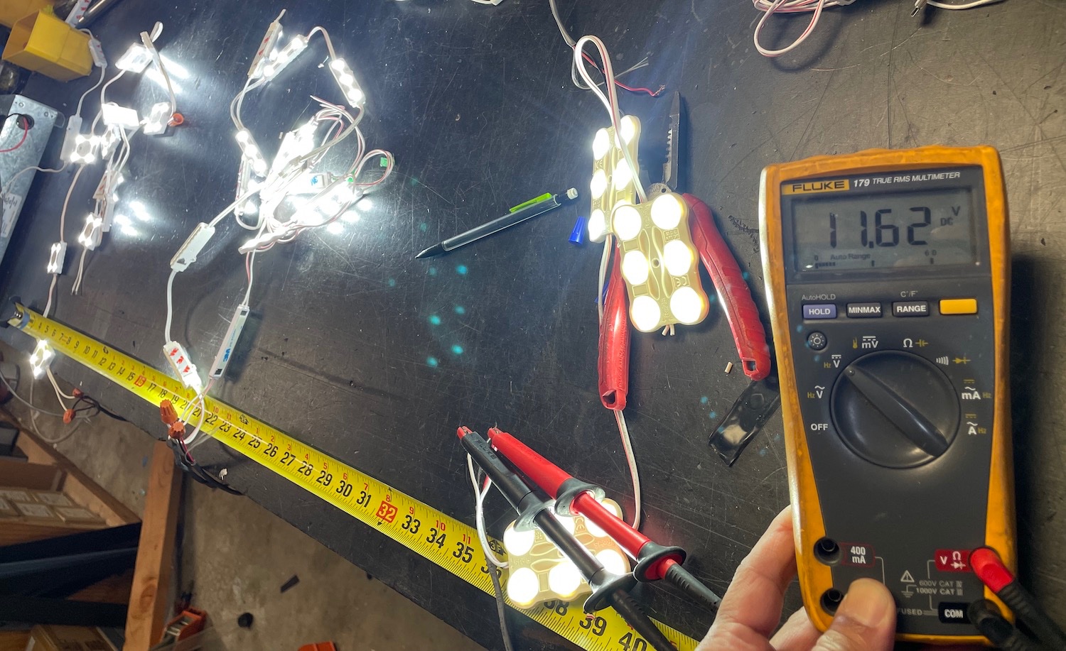

If you look at PSU 1, you'll notice that like most of how these signs are installed, the PSU goes to the first two letters of a group we'll call Jump 1, which is about 5' to 6' secondary cable length coming  from the LED PSU, and extension or jumper to the second group also 6' cable length, and to the third also 6' from Jump 2.  We took a volt meter and measured what the voltage was at each jump point.  Keep in mind, this much smaller than how signs are installed in the field, the secondary wiring used to crimp led string in letters then to jump points ins much longer as we all know, jumps are also much longer.  But this is a simple bench mark, we're not going extreme.
Jump 1 Voltage Measurements 11.89 Volts
Jump 2 Voltage Measurements 11.66 Volts
Jump 3 Voltage Measurements 11.62 Volts

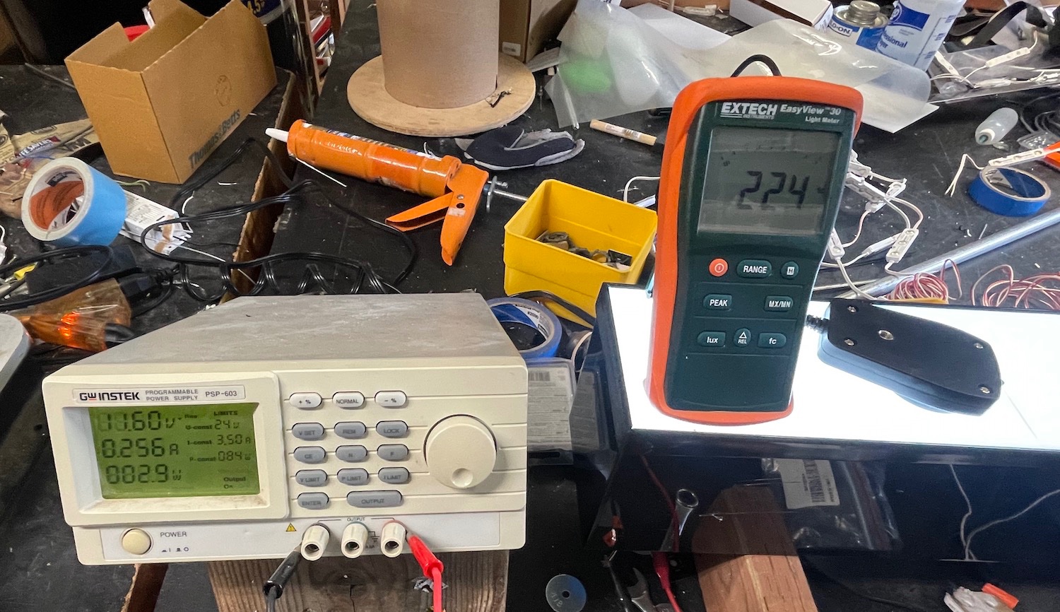

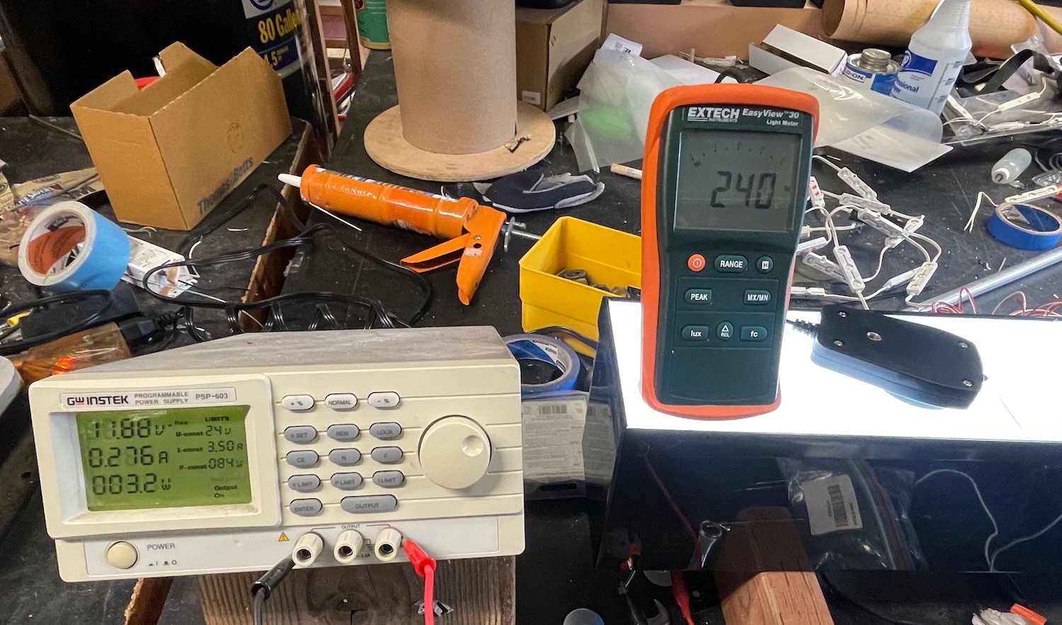

So, now that we have our voltage measurements of each jump, we'll use those voltage numbers to illuminate a channel to show you how the light output is affected using by the voltage drops on a CV system.

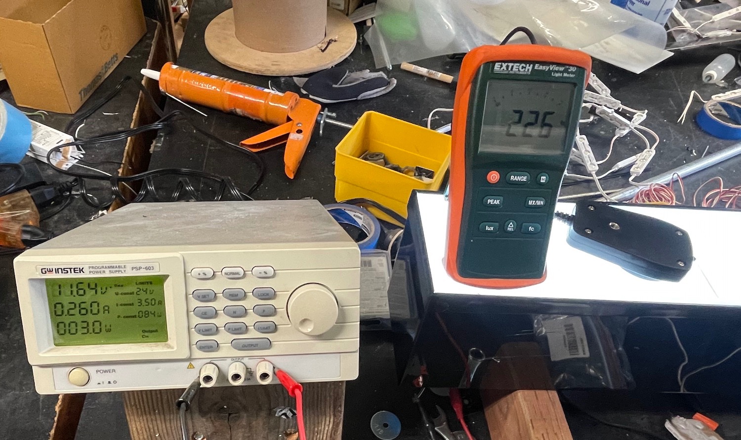

We used a LED power Supply where we control the voltage, also using a ExTech Light meter.
Jump 1 @ 11.89 Volts = 240 Foot Candles
Jump 2 @ 11.66 Volts = 226 Foot Candles
Jump 3 @ 11.62 Volts = 224 Foot Candles

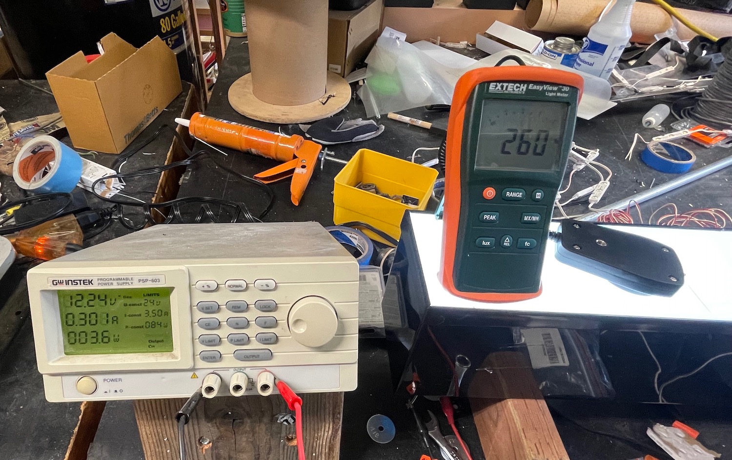

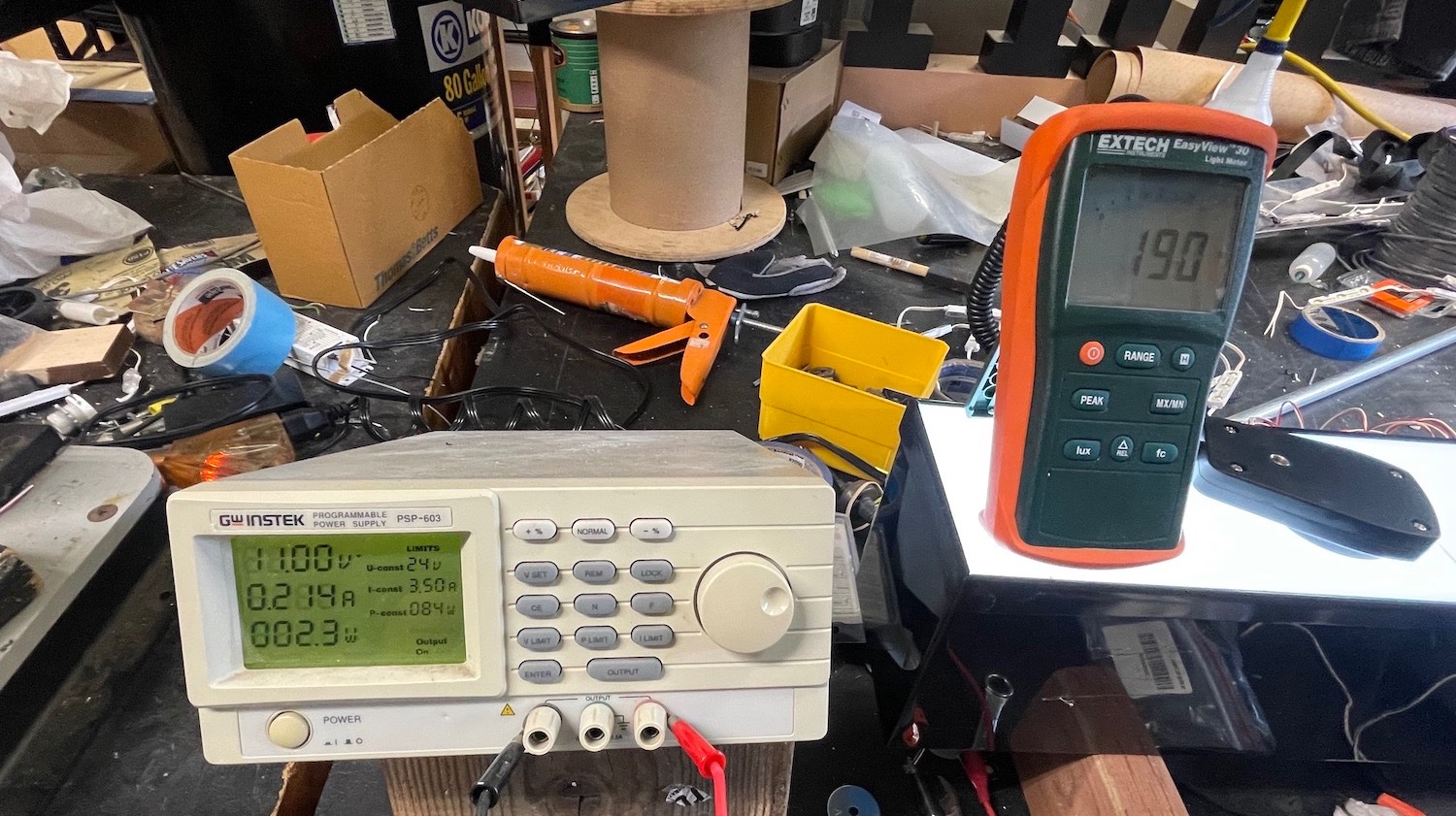

Like I said, this is a smaller version than what can happen in the field of installation where there is longer runs and jumps of secondary cable.  It's common to see 11volts at some points or jumps.  If we take this power supply down to simulate 11 volts, the light output drops to 190 Foot Candles.1844203770_11Volts.jpeg.90344f7d5a498414e717e6581052c4e0.jpeg
Now let's go the other way, let's go 12.24 Volts.  260 Foot candles, and climbs with each fraction of a volt up.  Not good for LED Modules

Let's show you the second part to this illustration and benchmark

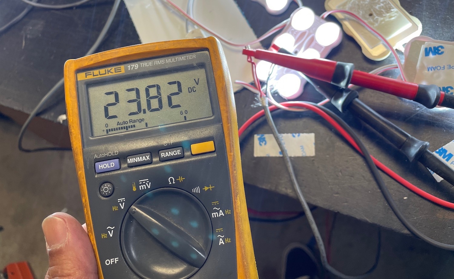

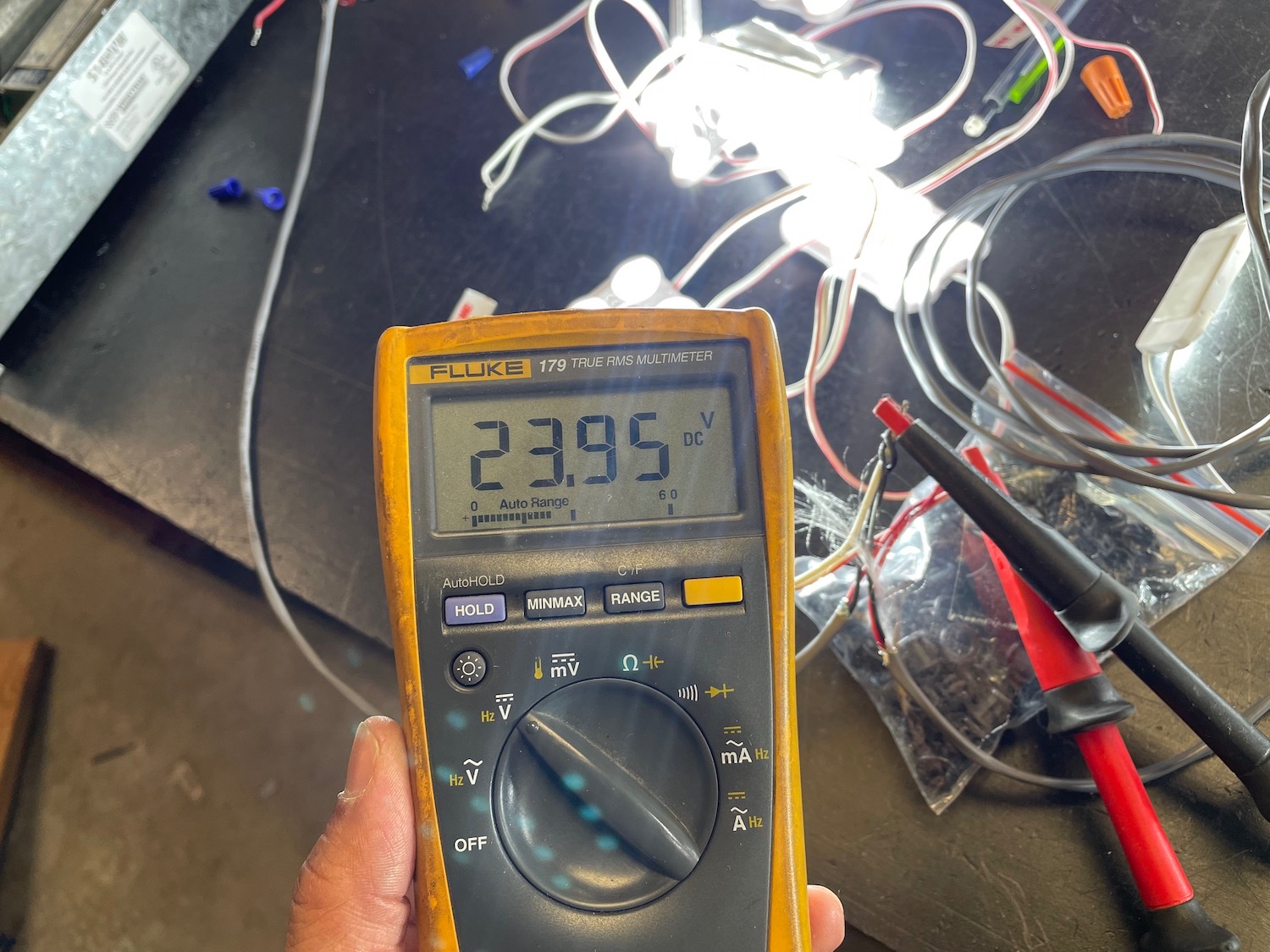

The 24V BrightON II Content Current LED Module Simulation

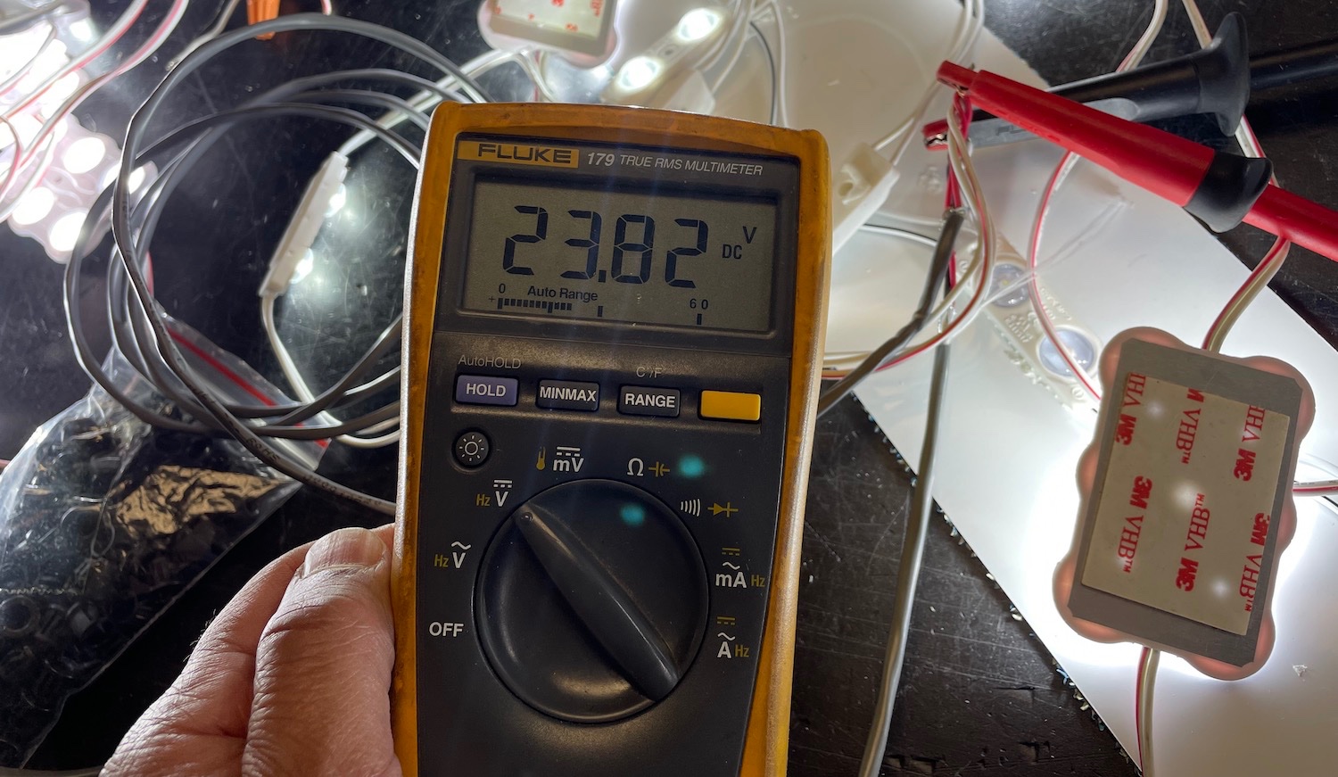

Jump 1 Voltage Measurement 23.95 Volts
Jump 2 Voltage Measurement 23.82 Volts
Jump 3 Voltage Measurements 23.82 Volts (No Change)

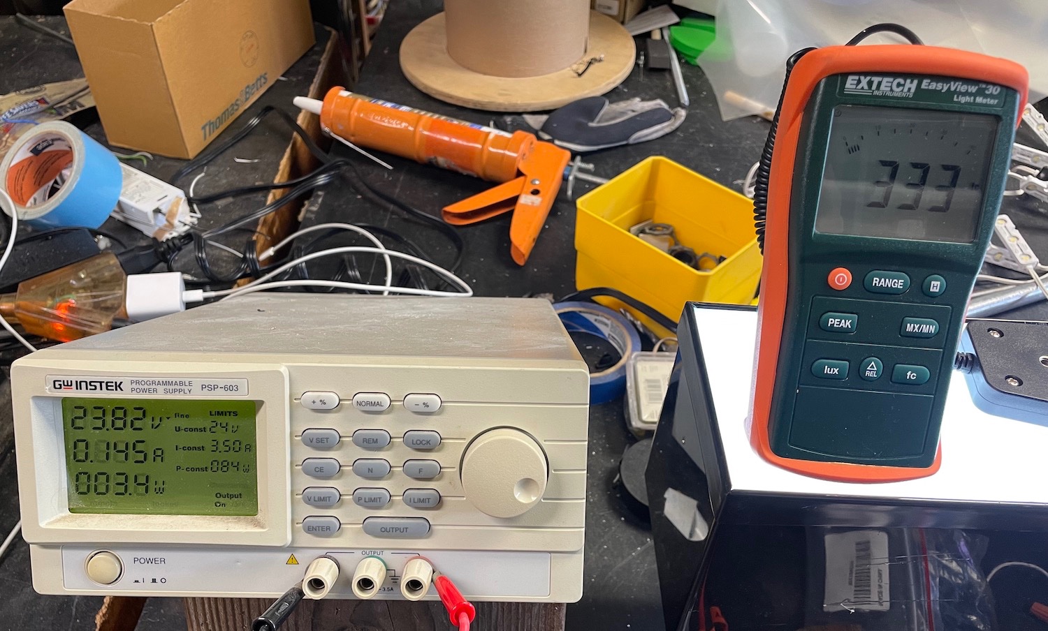

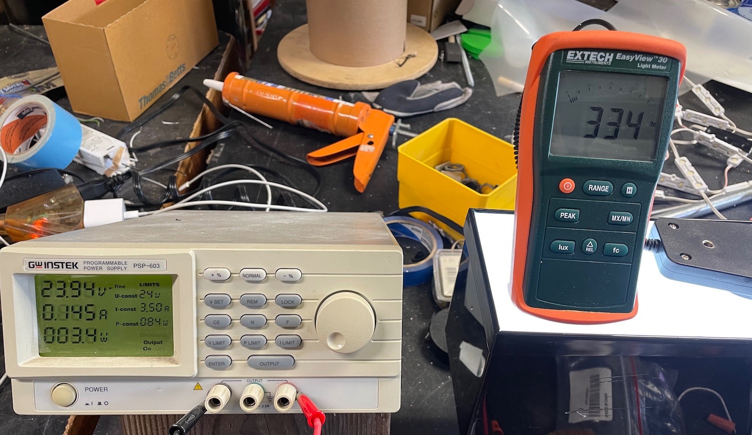

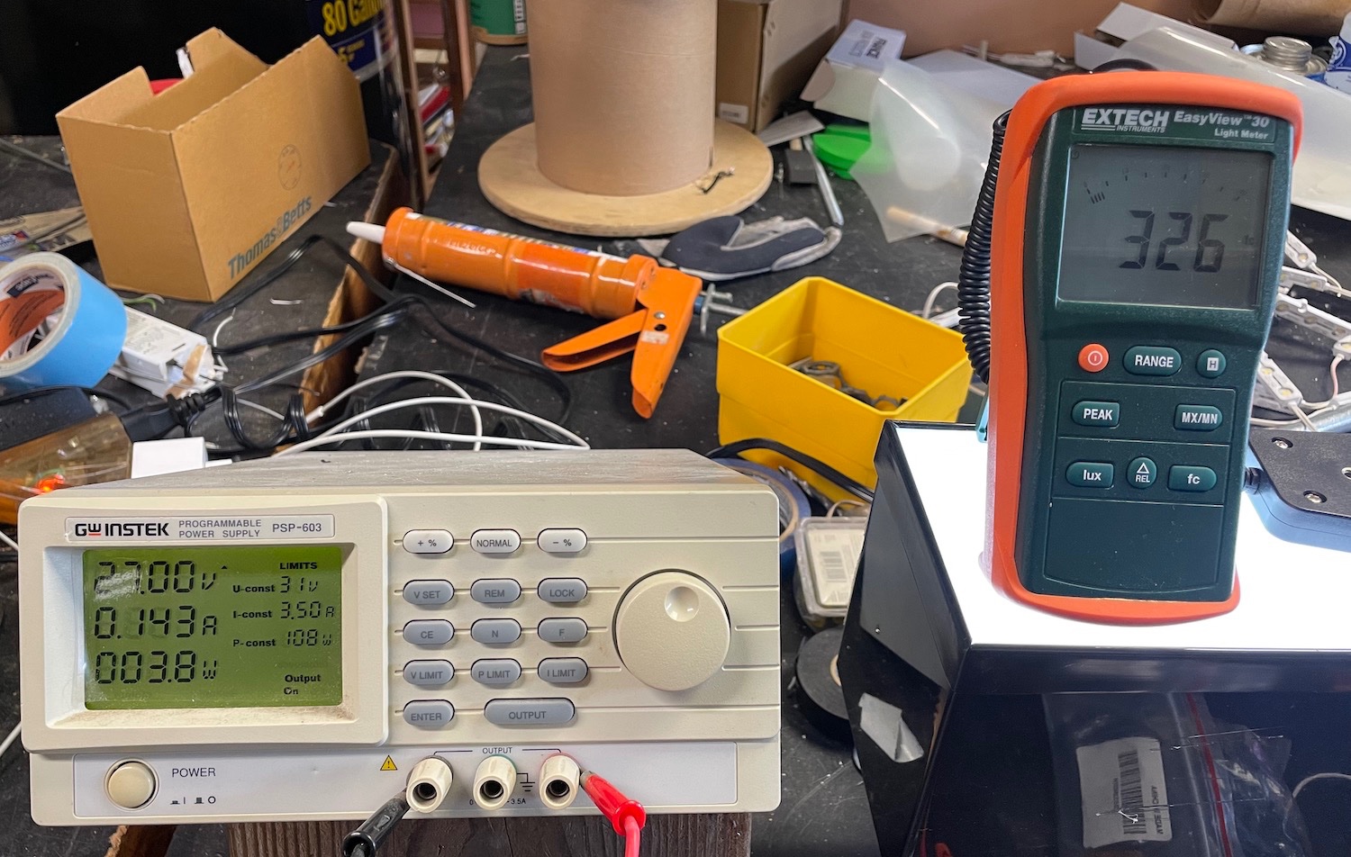

Now for the light output
Jump 1 @ 23.94 Volts = 334 Foot Candles
Since Jump 2 & 3 voltage measurements @ 23.82 Volts the light output is the same at 333 Foot Candles

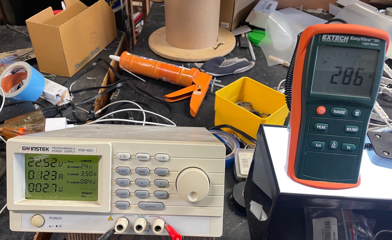

The drop in light was so minimal with a fraction of a volt it took us going down to 22.5 volts to see any kind of significant drop in light.
Let's go the other way and drive the string to 27 volts.  No affect on light output
