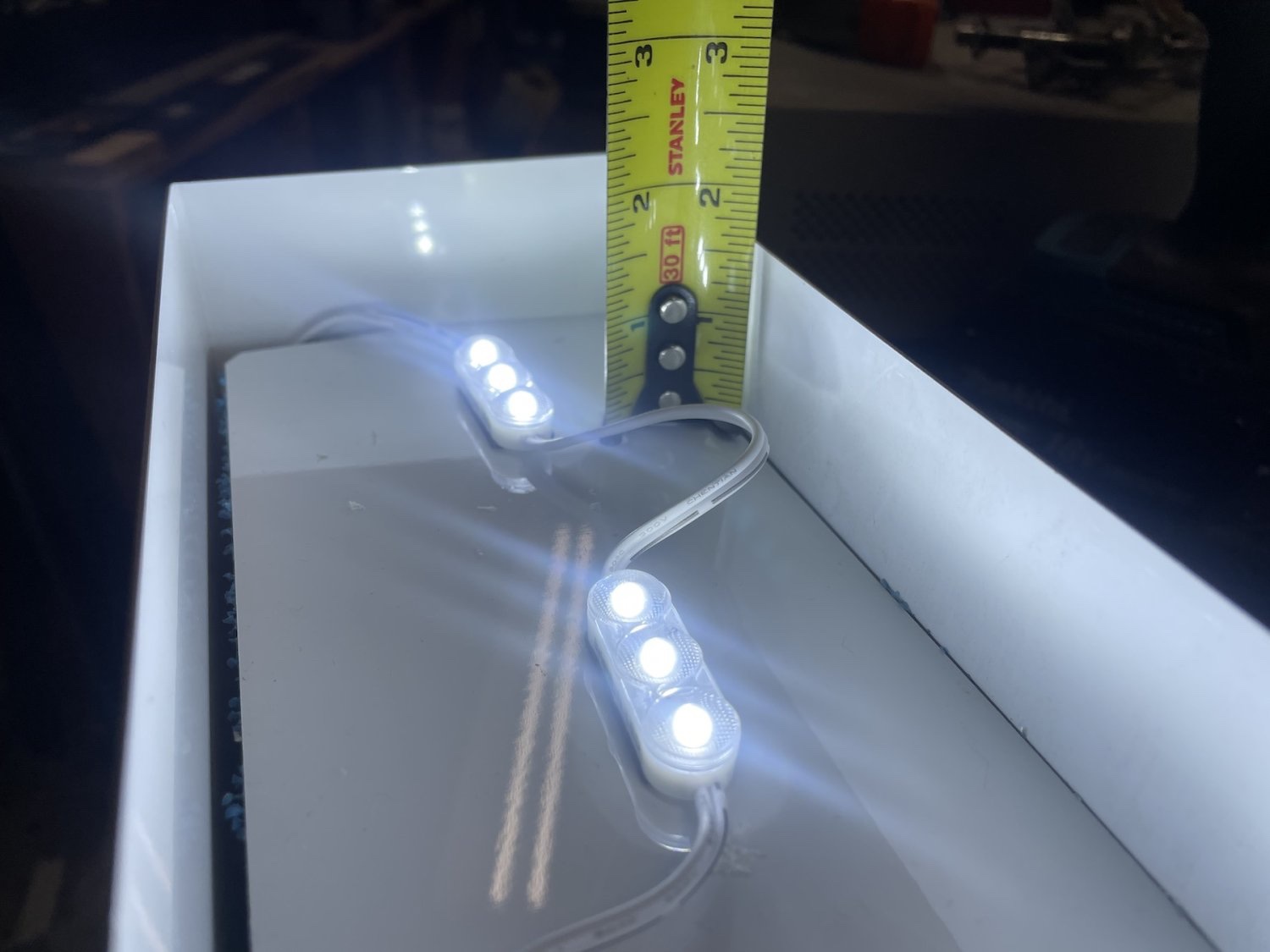

Here is a test channel at just 1.5" in depth, the acrylic used is 1/8" #7328 White, this is just using a Autohaus MC Grade 7328, and the result is even lighting no hotspots.  LD Acrylic is real nice for LED lighting, but at 1.5" depth, this regular grade sign white light nice.
4"W  x 24"L  x 5"D  Channel with false bottom, lighted up for a 1.5" Depth

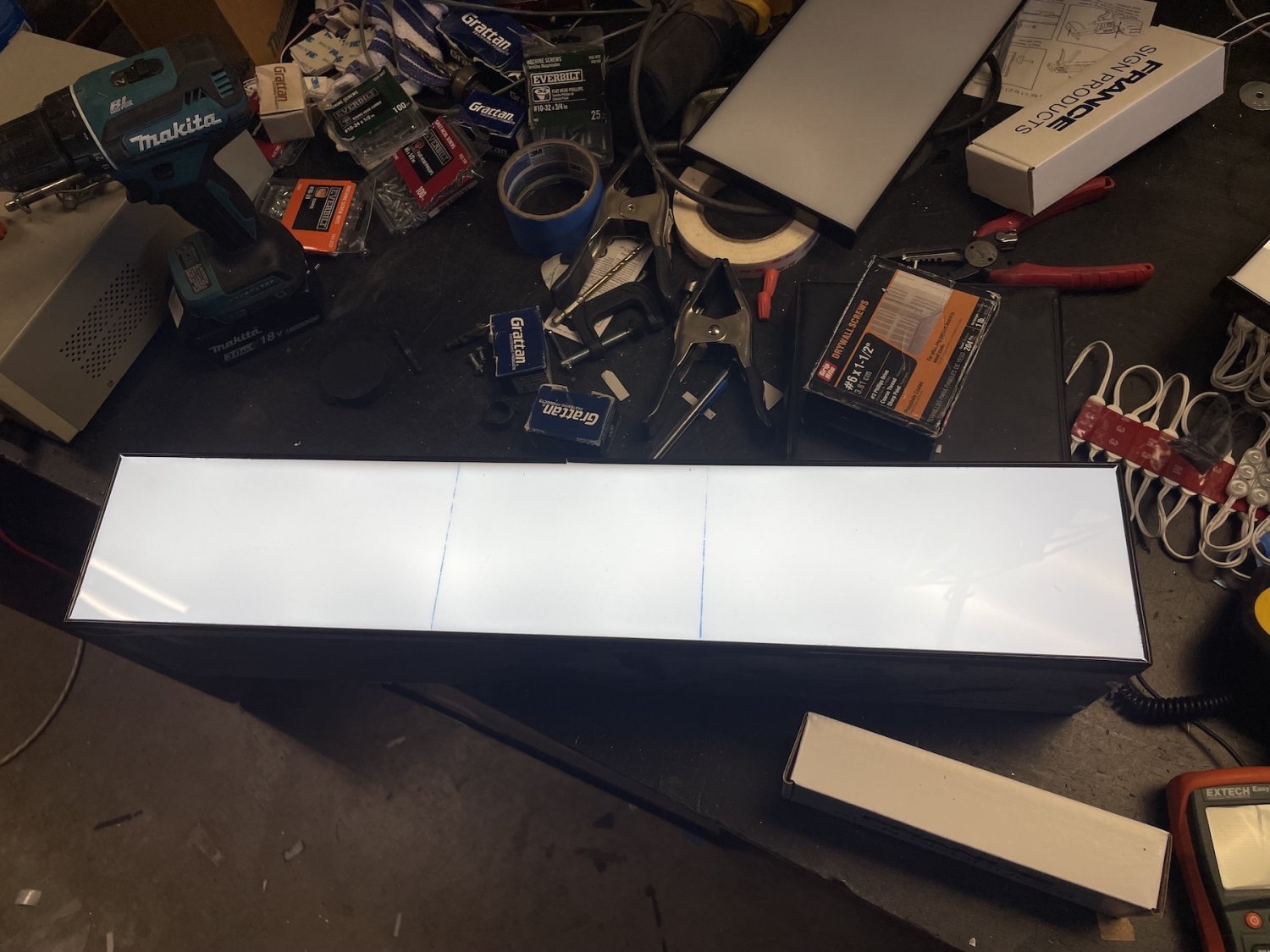

The Luminance right on the face measures something around 544 Foot Candle Average, that's some crazy brightness.  Typical .6w to .72w modules for 3" and 5" returns with usable light luminance is around 200 FC's. Using these for the same you get around 300-400 FC.
